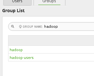

Hi, I am running Ranger 0.4 with local linux usersync.
On the linux boxes I have defined two additional groups called "hadoop-users" and "hadoop-admins".
After restarting ranger-usersync, there is just the group "hadoop-users" visible in Ranger-Admin-Webui, but "hadoop-admins" is missing?!?!
What is going on there ?!?!
Thanks and regards, Gerd

On all nodes the group hadoop-admins contains:
hadoop-admins:x:23231:w999711,w1004360,hdfs
and at least the user 'hdfs' is a local user and already sync'ed into Ranger, and I also restarted the ranger-usersync service with the following log entries:

But I still cannot see the group hadoop-admins in Ranger:
What else to check ? Is there some Debug output possible for usersync process ?!?

Hi @vperiasamy ,
yes, the user 'hdfs' has been sync'ed to Ranger and he is part of that group on OS level (the hadoop-admins group exists on all nodes in the cluster and 'hdfs' is member on all nodes as well).
=> user is there, but the group not....
