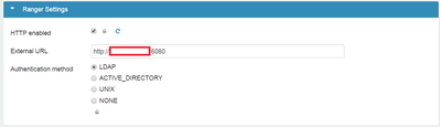

I set several sections of ranger on ambari.
Such as "Ranger Setting"
"LDAP Settings"

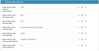

"Advanced ranger-ugsync-site".

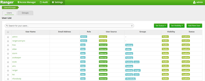

Unfortunately, when I login the ranger UI(http://RANGER_IP:6080), I could not see any user or group from my ldap server.
In addition, if I set those configurations successfully, how can I verify it ?
I Only verify in user/group page on Ranger UI. It is true?

Now, You need to check the setting in Ambari to make sure that OU and other paramaeters are correct.
Ranger logs will you the information on why sync is not happening.

The points of key are the following columns in Advanced ranger-ugsync-site.
ranger.usersync.source.impl.class org.apache.ranger.ldapusersync.process.LdapUserGroupBuilder
ranger.usersync.sink.impl.class org.apache.ranger.ldapusersync.process.PolicyMgrUserGroupBuilder
There are no hints on the HDP 2.3.2 document.
After these configuration, I could see the users of ldap server on my reanger UI.
