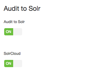

2) I already have Ambari Infra installed on Cluster? Do i need to use URL as http://solr_host:6083/solr/ranger_audits? where solr_host will be the hostname of machine where Ambari Metrics is installed?
>> if ambari infra is installed and you select Audit to solr options, then select solr cloud option and ambari infra/solr url will automatically populate
