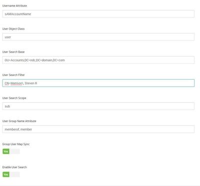

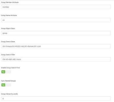

@spolavarapu I have not tried a fresh Group Sync with "Enable User Search" but I did enable it and below I provided a copy of the settings and the log output after restarting Ranger. Is there anything configured incorrectly? To see Enable User Search be effective, do I need to start with a fresh test? The Group Sync Users below were previously synced with that toggle switch in the NO Position. I have changed text to be generic, and only provide 1 group user log line.
UserSync:
GroupSync
Log is here:
24 Jul 2018 06:54:46 INFO LdapDeltaUserGroupBuilder [UnixUserSyncThread] - LdapDeltaUserGroupBuilder initialization started 24 Jul 2018 06:54:46 INFO LdapDeltaUserGroupBuilder [UnixUserSyncThread] - LdapDeltaUserGroupBuilder initialization com pleted with -- ldapUrl: ldaps://LDAP.NDC.DOMAIN.COM:636, ldapBindDn: CN=svks-dw-ldap,OU=Services,OU=Administrators, DC=ndc,DC=domain,DC=com, ldapBindPassword: ***** , ldapAuthenticationMechanism: simple, searchBase: dc=hadoop,dc=apache ,dc=org, userSearchBase: [OU=Accounts,DC=ndc,DC=domain,DC=com], userSearchScope: 2, userObjectClass: user, userSearchF ilter: CN=Matison\, Steven R, extendedUserSearchFilter: null, userNameAttribute: sAMAccountName, userSearch Attributes: [uSNChanged, sAMAccountName, modifytimestamp], userGroupNameAttributeSet: null, pagedResultsEnabled: true, pagedResultsSize: 500, groupSearchEnabled: true, groupSearchBase: [OU=Groups,OU=KS,DC=ndc,DC=domain,DC =com], groupSearchScope: 2, groupObjectClass: group, groupSearchFilter: CN=KS-ABG-ABC Users, extendedGroupSearchFil ter: (&null(|(member={0})(member={1}))), extendedAllGroupsSearchFilter: null, groupMemberAttributeName: member, group NameAttribute: cn, groupSearchAttributes: [uSNChanged, member, cn, modifytimestamp], groupUserMapSyncEnabled: true, gro upSearchFirstEnabled: true, userSearchEnabled: true, ldapReferral: ignore 24 Jul 2018 06:54:46 INFO UserGroupSync [UnixUserSyncThread] - Begin: initial load of user/group from source==>sink 24 Jul 2018 06:54:46 INFO LdapDeltaUserGroupBuilder [UnixUserSyncThread] - LdapDeltaUserGroupBuilder updateSink started 24 Jul 2018 06:54:46 INFO LdapDeltaUserGroupBuilder [UnixUserSyncThread] - Performing Group search first 24 Jul 2018 06:54:47 INFO UnixAuthenticationService [main] - Enabling Protocol: [SSLv2Hello] 24 Jul 2018 06:54:47 INFO UnixAuthenticationService [main] - Enabling Protocol: [TLSv1] 24 Jul 2018 06:54:47 INFO UnixAuthenticationService [main] - Enabling Protocol: [TLSv1.1] 24 Jul 2018 06:54:47 INFO UnixAuthenticationService [main] - Enabling Protocol: [TLSv1.2] 24 Jul 2018 06:54:47 INFO LdapDeltaUserGroupBuilder [UnixUserSyncThread] - extendedAllGroupsSearchFilter = (&(objectclass=group)(CN=KS-ABG-ABC Users)(|(uSNChanged>=0)(modifyTimestamp>=19691231070000Z))) 24 Jul 2018 06:54:51 INFO LdapDeltaUserGroupBuilder [UnixUserSyncThread] - longUserName: CN=Doe\, John,OU=Resource Admins,OU=Administrators,DC=ndc,DC=domain,DC=com, userName: Doe[ 19 additional results omitted ] 24 Jul 2018 06:54:51 INFO LdapDeltaUserGroupBuilder [UnixUserSyncThread] - No. of members in the group KS-ABG-ABC Users = 20 24 Jul 2018 06:54:51 INFO LdapDeltaUserGroupBuilder [UnixUserSyncThread] - LdapDeltaUserGroupBuilder.getGroups() completed with group count: 1 24 Jul 2018 06:54:51 INFO LdapDeltaUserGroupBuilder [UnixUserSyncThread] - User search is enabled and hence computing user membership. 24 Jul 2018 06:54:51 INFO LdapDeltaUserGroupBuilder [UnixUserSyncThread] - extendedUserSearchFilter = (&(objectclass=user)(|(uSNChanged>=0)(modifyTimestamp>=19691231070000Z))(CN=Matison\, Steven R)) 24 Jul 2018 06:54:51 INFO LdapDeltaUserGroupBuilder [UnixUserSyncThread] - uSNChangedVal = 760228369and currentDeltaSyncTime = 760228369 24 Jul 2018 06:54:51 INFO LdapDeltaUserGroupBuilder [UnixUserSyncThread] - Updating user count: 0, userName: smatison 24 Jul 2018 06:54:51 INFO LdapDeltaUserGroupBuilder [UnixUserSyncThread] - LdapDeltaUserGroupBuilder.getUsers() completed with user count: 0 24 Jul 2018 06:55:01 ERROR LdapDeltaUserGroupBuilder [UnixUserSyncThread] - sink.postUserGroupAuditInfo failed with exception: POST http://c7305.ndc.doman.com:6080/service/xusers/ugsync/auditinfo/ returned a response status of 400 Bad Request 24 Jul 2018 06:55:01 INFO UserGroupSync [UnixUserSyncThread] - End: initial load of user/group from source==>sink 24 Jul 2018 06:55:01 INFO UserGroupSync [UnixUserSyncThread] - Done initializing user/group source and sink <br>

With the above configuration (after "Enable User Search" is turned on), you should now be able to see the user (smatison) with samaccountname. Do you see that user in ranger admin?
Few points to consider:
1. When "Enable Group Search First" is "ON" and "Enable User Search" is "OFF", Ranger syncs users using the "Group Member Attribute" which is in general configured with "CN" of the user.
2. When "Enable Group Search First" is "ON" and "Enable User Search" is "ON", Ranger syncs users using the value configured for "Username Attribute" (which is samaccountname in your case).
3. Once the users or groups are sync'd to Ranger, they are not deleted by Ranger automatically. It is a manual operation by ranger admin to go and delete the unused users/groups from UI.

I had to modify my User Search Filter. After I did this the group users synced with UserName = sAMAccountName. However, when doing this, it made UserSync go through the entire LDAPS list of users (1000s)...
