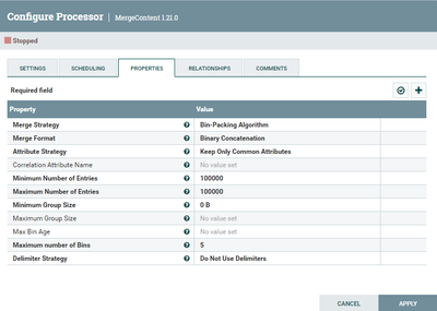

MergeContent merging 100,000 FlowFiles (min). You did not share any component configurations here.
Is the MergeContent configured correctly to make sure each merge generated is 100,000 FlowFiles?
Generally speaking, I would recommend using two MergeContent processors in series to reduce NiFi heap memory usage. The more FlowFiles allocated to MergeContent bins, the more NiFi heap usage. So first MergeContent merging say 20,000 min, followed by second MergeContent merging 5 min would achieve the same but with lower heap usage.

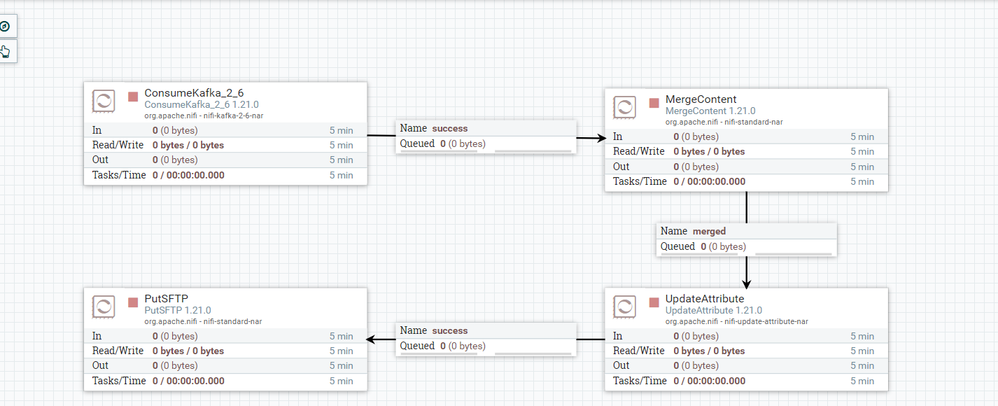

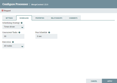

I don't have enough resource to make a nifi cluster with 3 nodes. I just use 1 node and flowfiles are 100,000 per second not min. This is more details.
