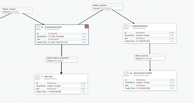

Hey Andrew,
If your message is a valid JSON (it seems to be), then a parser is able to read it an decode a literal string. The next trick is to put this results into a FlowFile content/body and run another EvaluateJsonPath/JoltTransformer chain. I did a quick experiment here, and it seems to work fine.
