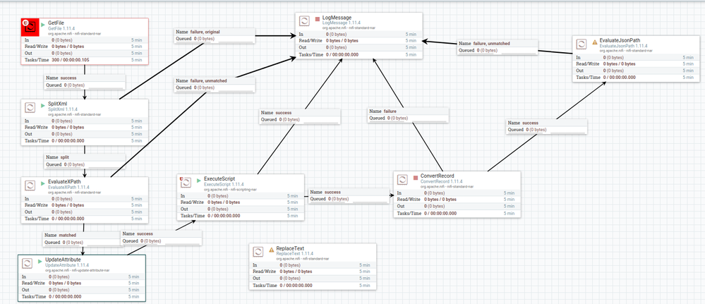

Here is the process to the point I got stuck. So I have the original xmls, I do a split to separate the child xmls that are the target of my analysis but they contain duplicate fields. I didn’t find a way to use the ReplaceText to change only the 1st encountered element in order to append an ID so it may be unique. Another approach that I found was to use a Python script attached below, that did the job, but I wonder if is there way to it in one single process.
