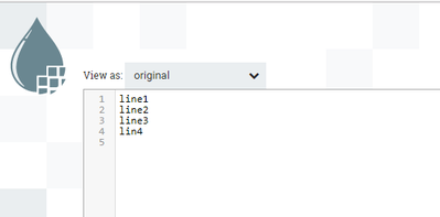

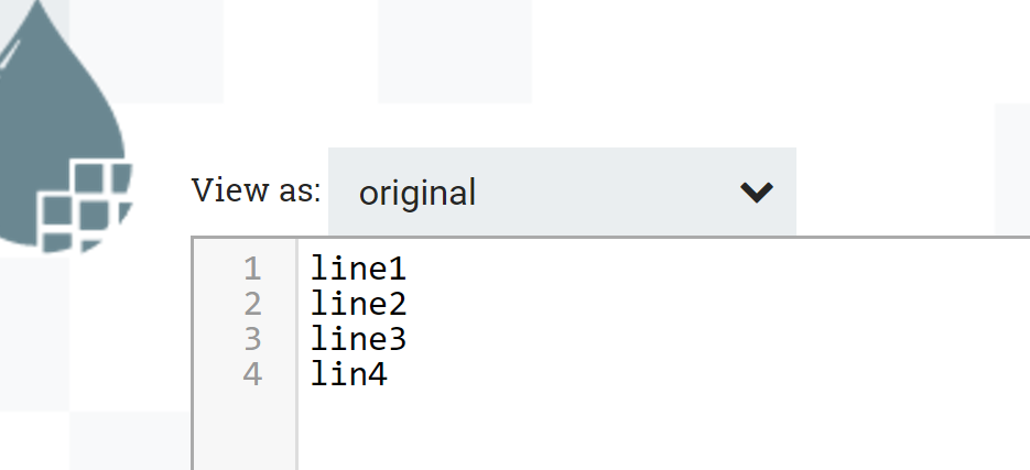

I am observing a new line is added in the beginning after replacing a text. but when observed through nifi ui I do not see the new line in the beginning.

Can you once check your replace text processor configurations

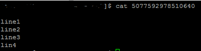

if the Replacement Strategy property as Prepend that means you are adding new line at starting of the file.
As that new line won't show in NiFi UI but when you do cat on the file then only it shows the new line.

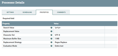

@Shu Thanks for the response I appreciate it. No I am not using Prepend strategy I am using regex replace all attached is the image

@dhieru singh,
If your file having any new line as first line of your file that would won't show in NiFi UI.
you need to use another replace text processor following with the existing replace text processor

As you are having replace text processor with
\n+\s //matches for only empty lines in between the text but not first
If you have empty lines in between the text then you are going to replace them with shift+enter.
But in this case you are having empty line at starting of the file then you need to take off them,that's the reason why you need to use another replace text processor.
