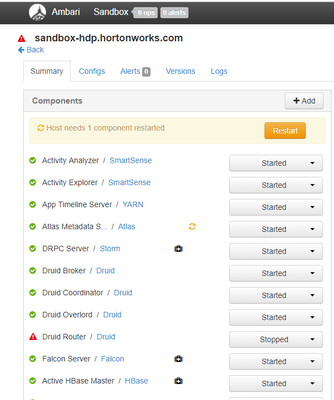

Kindly check my log file and list of services
aa.txt
New Member
New Member

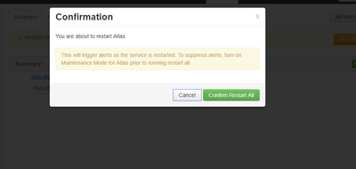

This is what happens when I try to restart it

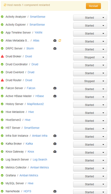

New Member
and here is the list of service i have
