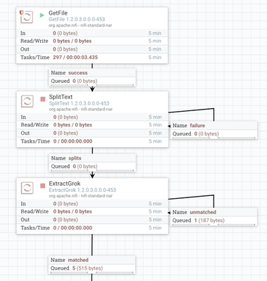

I built the following workflow using:
  • 1) GetFile – fetch the file (with the data above)
  • 2) SplitText – I split the file up into 1 flowfile per line
  • 3) ExtractGrok – I use a Grok expression to pull out Time (grok.time attribute), Sequence (grok.sequence attribute), Source (grok.source attribute), Destination (grok.destination attribute), Action (grok.action attribute) and Data (grok.data attribute).
My Grok pattern:
(?<severity>.{1}) (?<time>.{8}) (?<sequence>.{8}) (?<source>.{12}) (?<destination>.{12}) (?<action>.{30}) %{GREEDYDATA:data}
If you look at the data above, there are a total of 6 lines – where 5 lines match my Grok pattern. I likely wouldn’t want to collect the unmatched flowfiles because there will always be an unmatched pattern if the file contains “---------- -------- ------------ ------------ ------------------------------ ------------------------------------------------------------------------------------ Start 2013/04/29 00:01:34”.

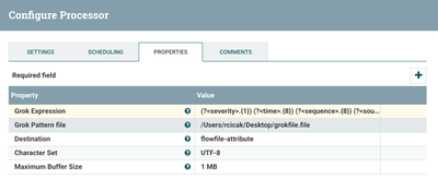

The Grok Pattern file (is attached). I used one I found on google – that had a bunch of pre-defined regular expressions.

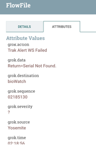

Grok will output my attributes as I define them in my Grok Expression, where each FlowFile will associate a group with my specified attribute:

The value of the FlowFileAttribute grok.expression is
Within Configure Processor of the ExtractGrok Processor, the value of Grok Expression is
${grok.expression}
The expected behavior is that the ExtractGrok Processor would continue to work as though the Grok Expression were hardcoded with (?<severity>.{1}) (?<time>.{8}) (?<sequence>.{8}) (?<source>.{12}) (?<destination>.{12}) (?<action>.{30}) %{GREEDYDATA:data}
