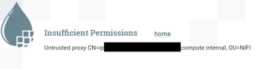

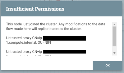

First let me say I've searched the board and I've seen the responses and I have a dilemma. Before my cluster establishes I can connect to my servers leveraging Initial Admin and the p12 that I've created.
I've verified that all of my nodes are in my authorizations.xml file and reference my users.xml accurately as /proxy resources
If I'm not attached to a node prior to joining the cluster the error appears like this

Well, I didn't RATW's...
My issue was NOT that my Initial Admin was wrong in the authorizers.xml file.  It was that my nodes weren't specified with a space between the , and the OU.
Make sure your authorizers.xml is EXACTLY as is created when you create your certificates... if you have issues stop NIFI fix the issue, delete users.xml and authorizations.xml and then restart NIFI.
