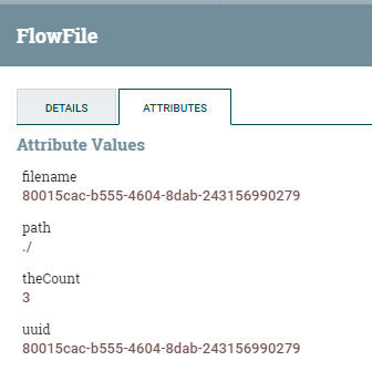

Also, including a screenshot of the Attributes tab showing the theCount attribute.

The UpdateAttribute success relationship has the result flowfile with the following attribute:
If I run the flow again , the new flowfile will have the following attribute:
Its strange that It did not work for you when set the initial value to 1 ? I dont see anything else wrong. If that still did not work for you, can you try to upgrade Nifi just to see if its not a bug with 1.19.1. I use 1.20 for testing but you can upgrade to the latest.
