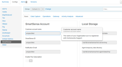

Created on 08-23-2018 01:46 PM - edited 08-17-2019 05:47 PM
hi, @Akhil S Naik
is correct, my memory was on the limit, do you know why i can't change the configuration of the different services on ambari? i have to add an SmartSense ID to start it
