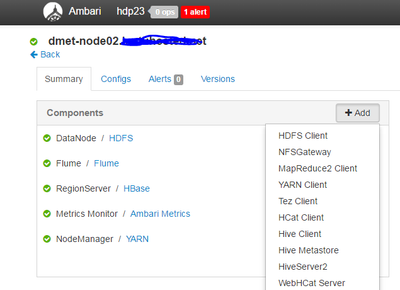

Click on hosts menu on ambari web UI
Click on host where you want to add client.
On the host page click on add button as below.

You can later always add clients in the host page of ambari with the +Add button.
