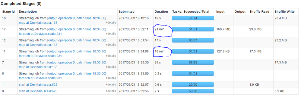

@srowen i don't think the upstream transformations and getting the stream's are not causing any delays ...as highlighted in the pic below .....only thing that's in minutes is foreachRDD (Eventhough there is no code in in it)
Stage Execution times
