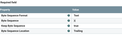

I tried with Split Content with these configurations:
But the first object is coming out {obj1}{ and the rest of the objects are coming out obj2}{ obj3}{

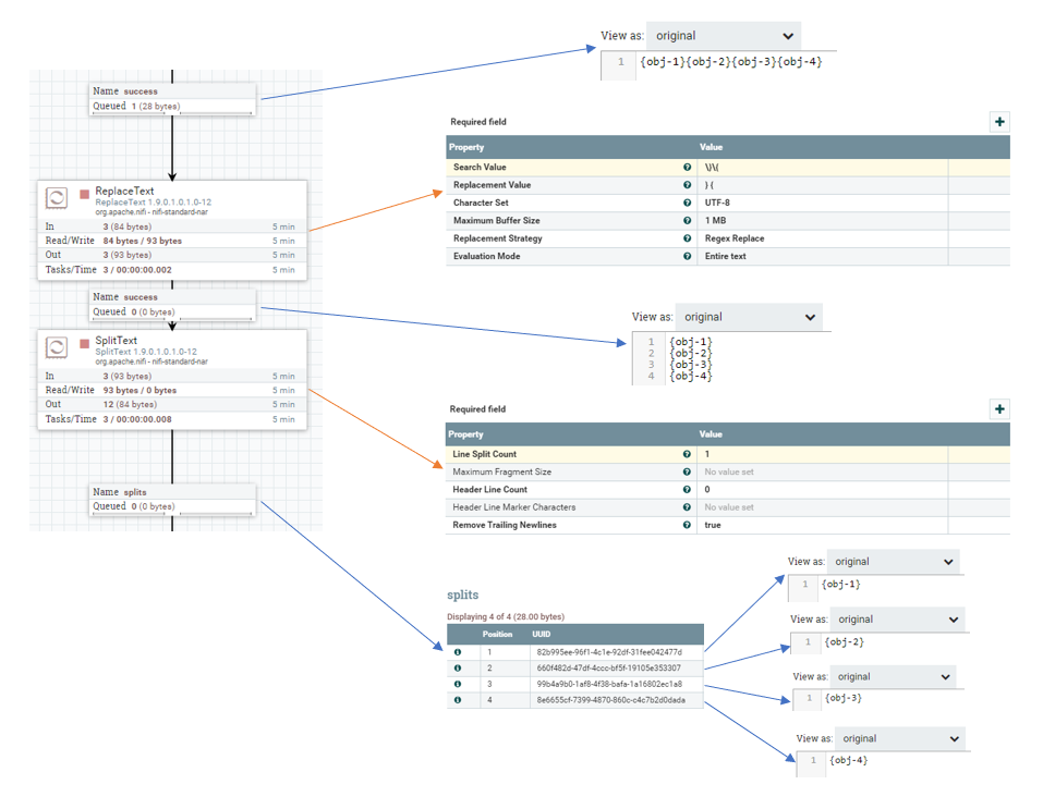

Hello,
one way to do it is to use the ReplaceText processor to add a line break after each object, and so having one line for each object in your FlowFile. To do so just replace "}{" by "} -linebreak- {".
Note that you have to escape brackets in your Search Value :
And that you have to use Shift+Enter in your Replacement Value to add the line break :
Then just use the SplitText processor with Line Count Split to 1 to split your input flow file into one flow file for each line.
Hope it helps 🙂
