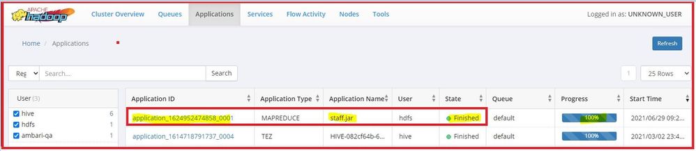

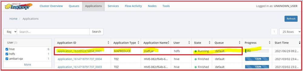

YARN UI showing the job running and completing
Completed successfully

21/07/03 22:52:15 INFO mapreduce.Job: Job job_1625340048377_0003 running in uber mode : false
21/07/03 22:52:15 INFO mapreduce.Job: map 0% reduce 0%
21/07/03 22:56:45 INFO mapreduce.Job: map 75% reduce 0%
21/07/03 22:58:10 INFO mapreduce.Job: map 100% reduce 0%
21/07/03 22:58:13 INFO mapreduce.Job: Job job_1625340048377_0003 completed successfully

21/07/03 22:58:14 INFO mapreduce.ExportJobBase: Transferred 1.1055 KB in 630.3928 seconds (1.7957 bytes/sec)
21/07/03 22:58:14 INFO mapreduce.ExportJobBase: Exported 6 records.
