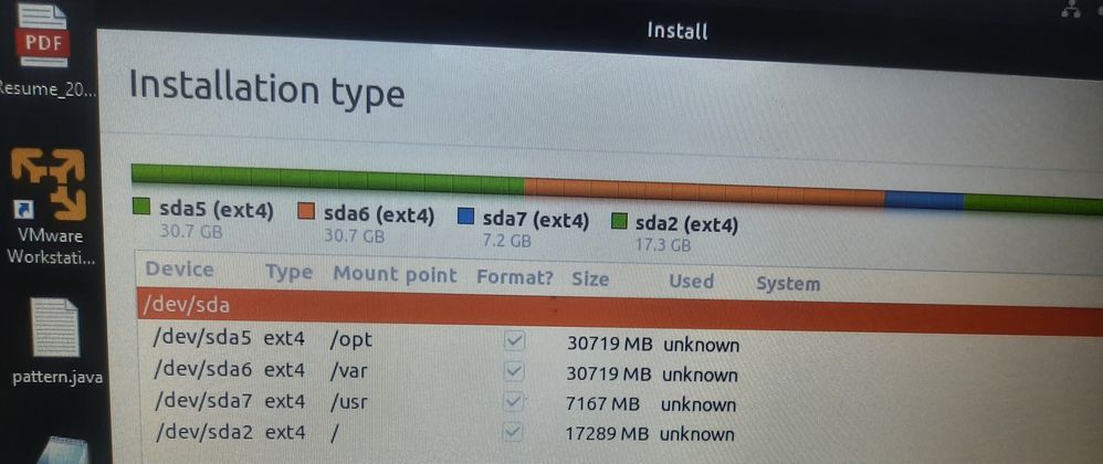

Virtualbox specs:
4GB RAM
80GB Disk
Ubuntu partition: /opt - 30GB   /var - 30G      /usr - 7GB      / 17GB
as per Cloudera manager server specifications
