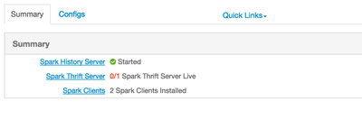

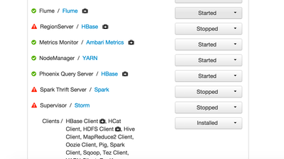

Created on 02-04-2016 04:22 PM - edited 08-19-2019 03:06 AM
This is what it looks like
When you stop through ambari then it will stop the following/all components.
If just want to start or stop particular component then you can click that particular service and take the action.
Click Spark Thrift Server and you can just start or stop that .
I clicked thrift server and I can start from there...

@Greenhorn Techie spark client is client so there is no start and stop.
As you can see from my screeen shot , when you stop spark , it will stop all those components.
