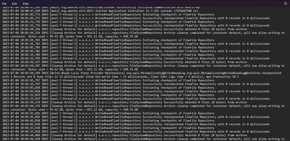

  4. This is the process that's looping over and over in the nifi-app.log file

@c3turner7,
For 1: that is actually not an error and you might ignore it. Does it get written with ERROR because as far as I know, that line is an INFO and it causes no issue/problem.
For 2: based on my tests, you can ignore that message in windows as I received it constantly and NiFi works without any issue.
For 3: Try recording your screen and see if any error gets printed in the CMD before being closed. When this happend to me, I had an issue with JAVA and it got printed in the logs or within the CMD window. Nevertheless, what CMDs are you trying to execute and why? They all have a purpose and if you start running them in blind you might cause other problems and make your debug much heavier than it already is.
For 4: those are INFO lines, meaning that they are not affecting your application and you can ignore them.

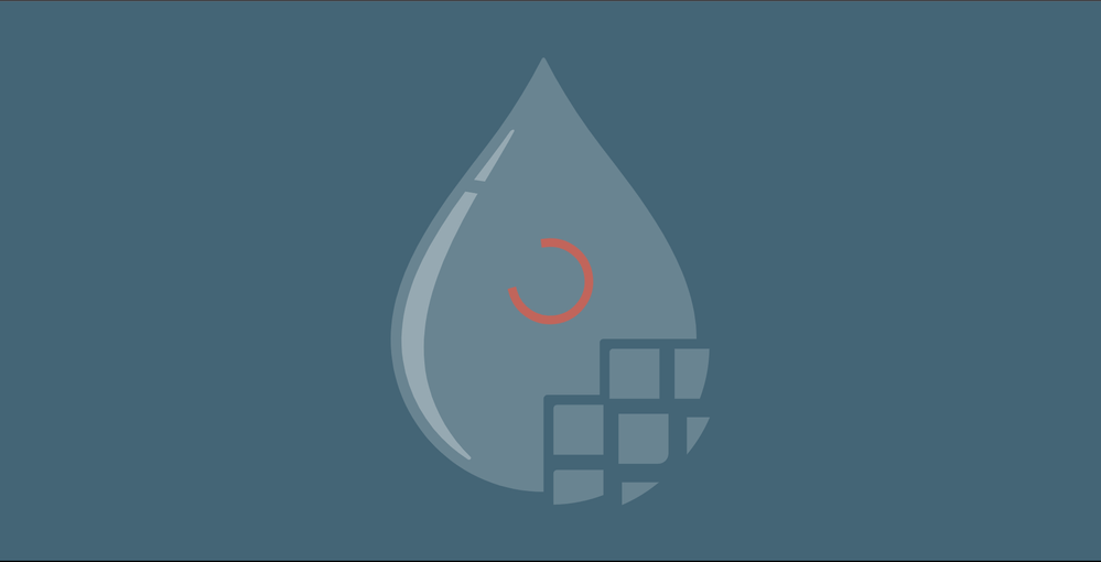

Frequent Visitor
Here's the screenshot of where I'm stuck at: Screenshot 2023-07-05 092753.png

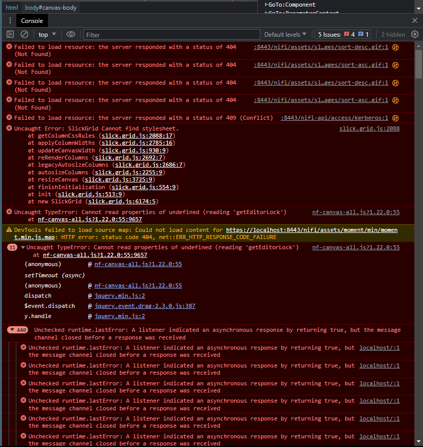

Frequent Visitor
good idea. Looks like errors relating to asset loading. I could try redownloading java 11? Or try java 8?  Screenshot 2023-07-05 150618.png
