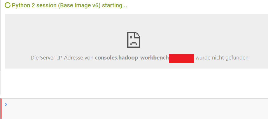

If I create a new project and open the workbench I get this error message on the right side of the workbench:
"The IP-Address of consoles.hadoop-workbench... could not be found"
All the initial templates (Python, Scala, R..) gave me the same result.
How can I resolve this problem?
Grateful for any help!

The problem could be solved with setting up the Wildcard DNS Subdomain for CDSW properly.
(CDSW 1.4.X documentation page 51)
