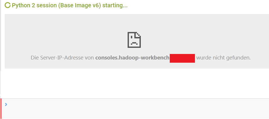

I could successfully deploy CDSW 1.4.2 on my CDH 5.14 with the Cloudera parcel.
If I create a new project and open the workbench I get this error message on the right side of the workbench:
"The IP-Address of consoles.hadoop-workbench... could not be found"
All the initial templates (Python, Scala, R..) gave me the same result.
How can I resolve this problem?

The problem could be solved with setting up the Wildcard DNS Subdomain for CDSW properly.
(CDSW 1.4.X documentation page 51)
