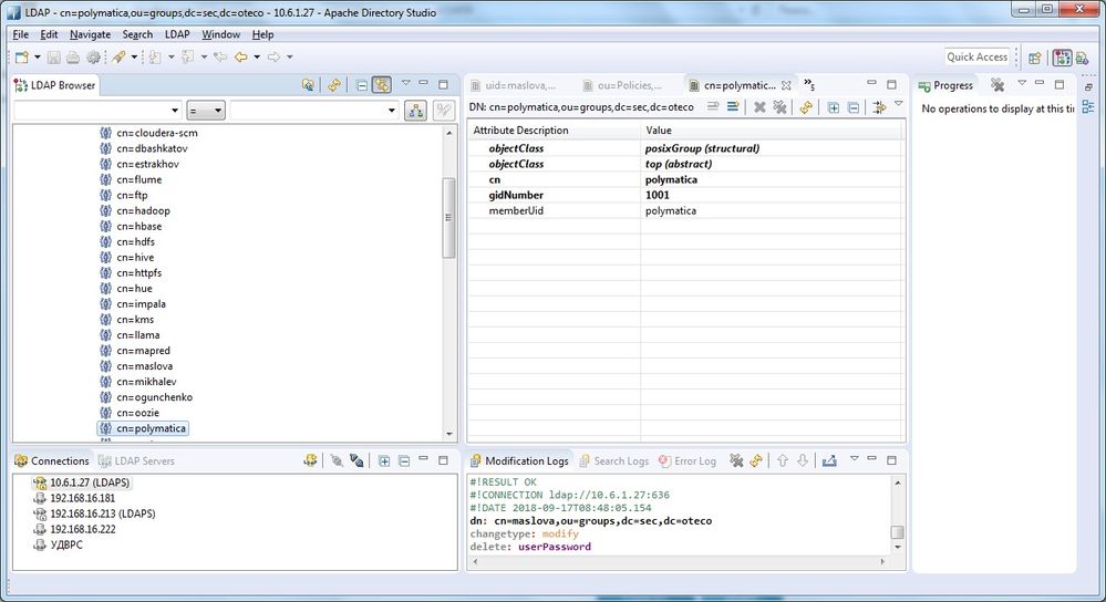

What I found in the log of Sentry
DEBUG org.apache.hadoop.security.LdapGroupsMapping: doGetGroups(maslova) return [polymatica]
But why??????
The user maslova in not in group polymatica neither in LDAP nor in OS.
All the mistakes disappear as I add group polymatica in Sentry admins, and in garnts for hive tables.
What is wrong?

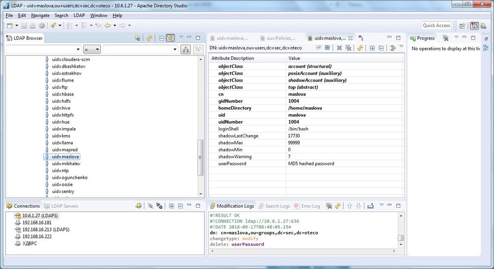

The changes you have adviced in search filter  (&(objectClass=posixAccount)(uid={0})) had an effect!
Now the command hdfs groups hdfs returns hdfs : hdfs
hdfs groups maslova
maslova : maslova
Now the search bind returns the group, which is in gidNumber of the account.

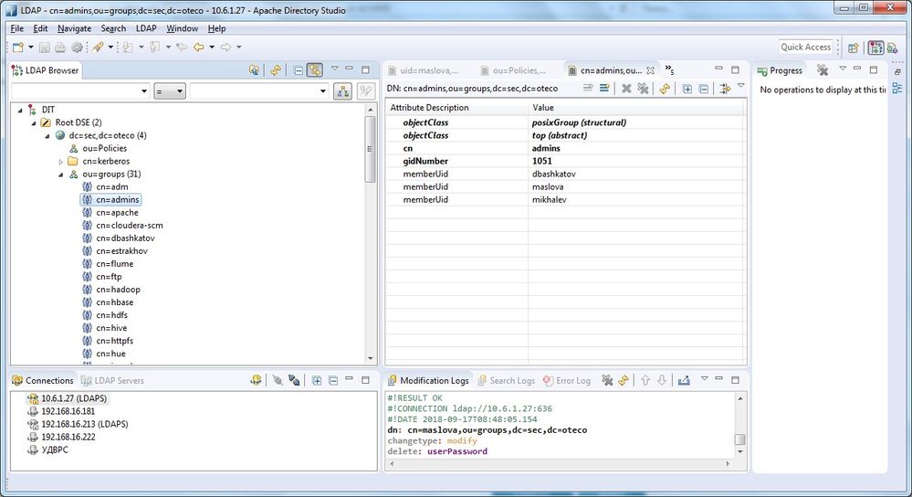

Something is wrong with these lines, I think
Re: The application won't work without a running HiveServer2 and Access denied erors after enabling
Contributor

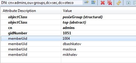

The reason of this problems was that HDFS is looking for uidNumber in memberUid and Hue is looking for uid in memberUid. As I added uidNumber in memberUid  for my user in addition to other memberUids everything started to work.
On the picture memberUid=1004 and memberUid=maslova is the same user
Is there any other method to fix the problem, because if we leave membership like this we would have to add users in groups twice: uids and uidnumbers
