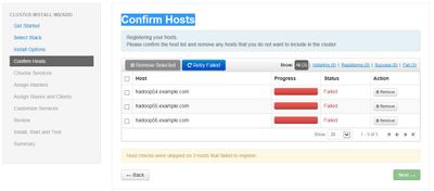

hadoop54.example.com is my ambari-server.55/56 are agent.Ambari is ok,when I install HDP got a problem on the step "Confirm Hosts".the log is:

Registering with the server...
Registration with the server failed.
