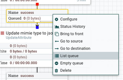

If you right click on the incoming connection a pop-up menu will appear:
Select List queue, then you can look at the data the ReplaceText is trying to process. It looks like the end of the file being split may have incomplete lines?
