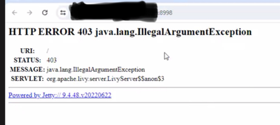

I have installed Livy service in Cloudera CDP (7.1.7) cluster, accessing the admin web ui throwing 403 error.
See the details below:

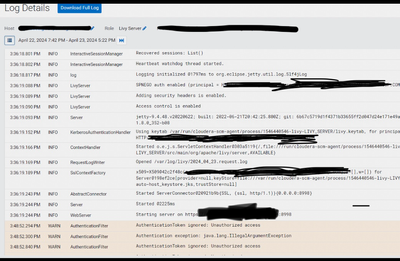

Hello @soumM
Seem Spnego is enabled for livy web UI.
Can you check Livy >> Configuration >> livy_spnego_enabled
If Spnego is enabled, you need to have a Kerberos ticket on the local machine, and the browser needs to be configured for Kerberos authentication.
You can uncheck spnego_enabled to allow anonomous user to access the web ui
Livy >> Configuration >> livy_spnego_enabled and try accessing it without any authentication.
