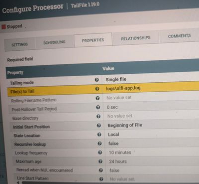

As per your guidance firstly I have taken TailFile processor and configured as below

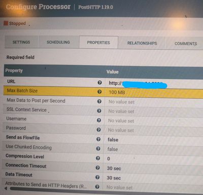

Next taken PostHTTP processor with below Configurations,in the PostHTTP url used is server hostname and port number because MiNiFi is running on this server and NiFi is running on localhost .correct me if I am wrong here.

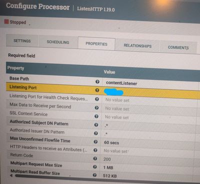

Nextly I have taken ListenHTTP and configured the listening port as the server port number where MiNiFi is running which is provided in PostHTTP.as below

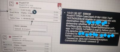

 Eneded the data flow here as per your guidance ,when I ran TailFile processor it picked the log file and next when started PostHTTP processor it throwed below error
Could you guide me whether my data flow is correct,if it is wrong what needs to be changed  to execute the remote file.
