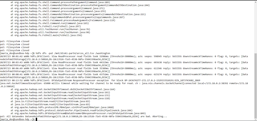

Created on ‎07-22-2020 08:01 PM - edited ‎07-22-2020 08:02 PM
- Mark as New
- Bookmark
- Subscribe
- Mute
- Subscribe to RSS Feed
- Permalink
@aakulov @Shelton Using the hdfs dfs -put has given me the following error. Could it be because my virtual machine (and the hadoop cluster running on top of it), the VDI file all reside on a external hard drive? It is not an SSD and read/write speeds aren't extremely fast. I believe I can get better performance if everything ran off my machine's own internal hard drive (which is an SSD).
Would using distcp help in this scenario?
