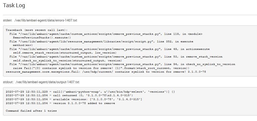

Created 07-29-2020 06:53 AM
Yes, I tried this workaround, and I still get this error :
Traceback (most recent call last):
File "/var/lib/ambari-agent/cache/custom_actions/scripts/remove_previous_stacks.py", line 118, in <module>
RemovePreviousStacks().execute()
File "/usr/lib/ambari-agent/lib/resource_management/libraries/script/script.py", line 352, in execute
method(env)
File "/var/lib/ambari-agent/cache/custom_actions/scripts/remove_previous_stacks.py", line 49, in actionexecute
self.remove_stack_version(structured_output, low_version)
File "/var/lib/ambari-agent/cache/custom_actions/scripts/remove_previous_stacks.py", line 53, in remove_stack_version
self.check_no_symlink_to_version(structured_output, version)
File "/var/lib/ambari-agent/cache/custom_actions/scripts/remove_previous_stacks.py", line 93, in check_no_symlink_to_version
raise Fail("{0} contains symlink to version for remove! {1}".format(stack_root_current, version))
resource_management.core.exceptions.Fail: /usr/hdp/current/ contains symlink to version for remove! 3.1.0.0-78
It seems that it fails because there are still symink to the old version in the directory /usr/hdp/current (at least on the server where ambari-server is hosted) :
root@server-01:~# ls -l /usr/hdp/current | grep 3.1.0.0-78
lrwxrwxrwx 1 root root 25 Jul 28 06:27 atlas-server -> /usr/hdp/3.1.0.0-78/atlas
lrwxrwxrwx 1 root root 31 Jul 28 06:27 hadoop-hdfs-datanode -> /usr/hdp/3.1.0.0-78/hadoop-hdfs
root@server-01:~# ls -l /usr/hdp/current | grep 3.1.4.0-315
lrwxrwxrwx 1 root root 26 Jul 28 10:44 atlas-client -> /usr/hdp/3.1.4.0-315/atlas
lrwxrwxrwx 1 root root 27 Jul 28 10:51 hadoop-client -> /usr/hdp/3.1.4.0-315/hadoop
lrwxrwxrwx 1 root root 32 Jul 28 10:51 hadoop-hdfs-client -> /usr/hdp/3.1.4.0-315/hadoop-hdfs
