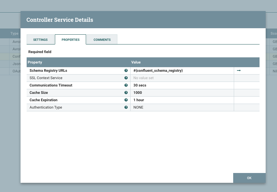

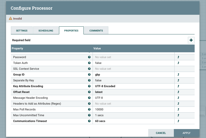

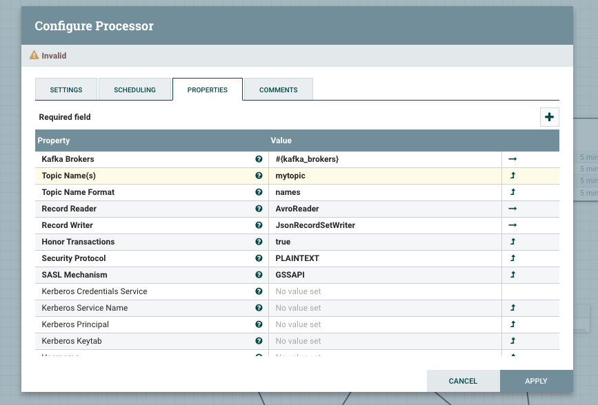

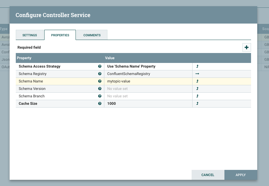

I am using Nifi 1.14.1, Kafka 2.13-2.7.1 and the processor ConsumeKafkaRecord_2_6 to process messages from a topic where the key and the value where both serialized using avro - schemas for the key and value are stored in the confluent schema registry. But the processor fails to parse the message because there is not a way - that I can see - to specify that both key and value are avro serialized with schemas stored in the confluent schema registry. The convention for naming the schema is usually [topic name]-value and [topic name]-key. I can read the messages just fine using kcat, formerly kafkacat using:

It turns out that I only need to specify that I am using "Confluent Content-Encoded Schema Reference" in the Avro Reader "Schema Access Strategy" field, in this case since I am following the schema registry conventions.
