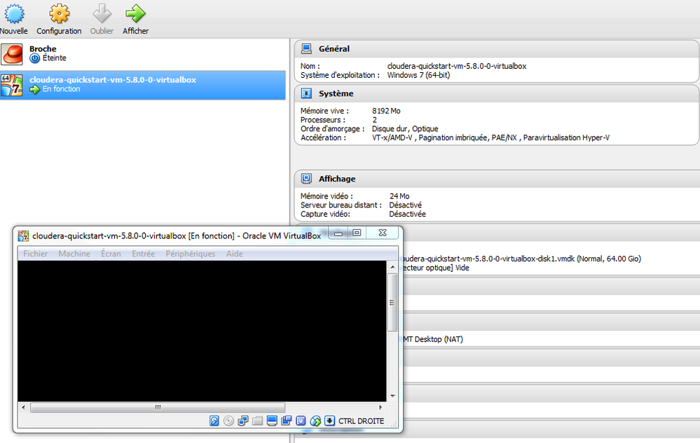

I've installed Oracle VM VirtualBox and downloaded Cloudera quickstart 5.8.0-0. I'm still not able to lauch the VM desktop. I'm stuck at the blackscreen after the loading bar is down (see image below)
I've enable virtualization in BIOS, and tried different set up (Windows and Red Hat) but still it won't start.
Any clue would be much appreciated!

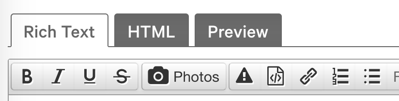

Also to post an image click on the camera image in the editor which opens up a screen allowing you to upload an image or add one by URL.

Now it's loading but stuck here (thanks for the tip to copy image :D)
thanks
