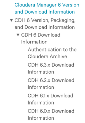

@hurryUpHarry The URL you are using is giving expected results because that URL is explicitly for CM repo and says "Cloudera Manager 6 Version and Download Information".
If you need CDH download information then you have to go one step next on same page for example notice the left side bar.
This consist the CDH repo information.
