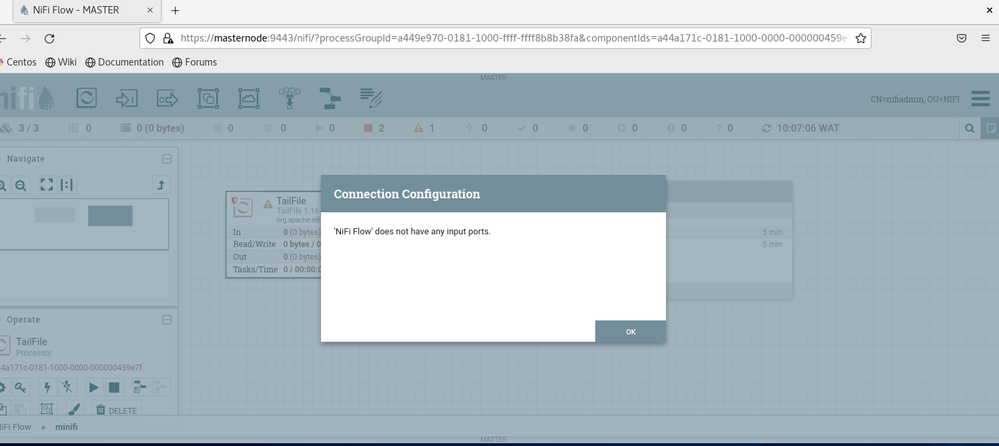

Very Strange: Nifi Flow does not have Input ports

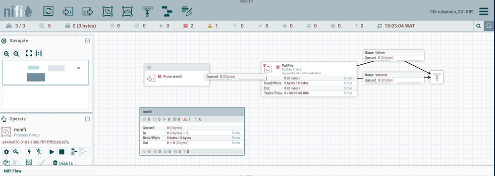

I am trying to do Minifi - Nifi s2s communication.
So, i was trying to generate a flow file(to use for minifi) on one of Secured Nifi cluster nodes.
- i dropped an input port on the root canvas & connected it to putfile processor

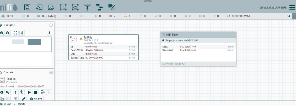

- i created a process group. I dropped tailfile processor & Remote Process Group processor inside it.

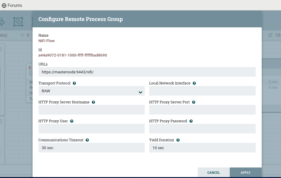

- I configured RPG with the url of the root canvas
I don't actually know what i am doing wrong because all my configurations seems to be good.

Thanks to everyone for your kind help.
Eventually, i got to know that the problem is with the access policy.
I got the clue from here:
https://bryanbende.com/development/2016/08/30/apache-nifi-1.0.0-secure-site-to-site
