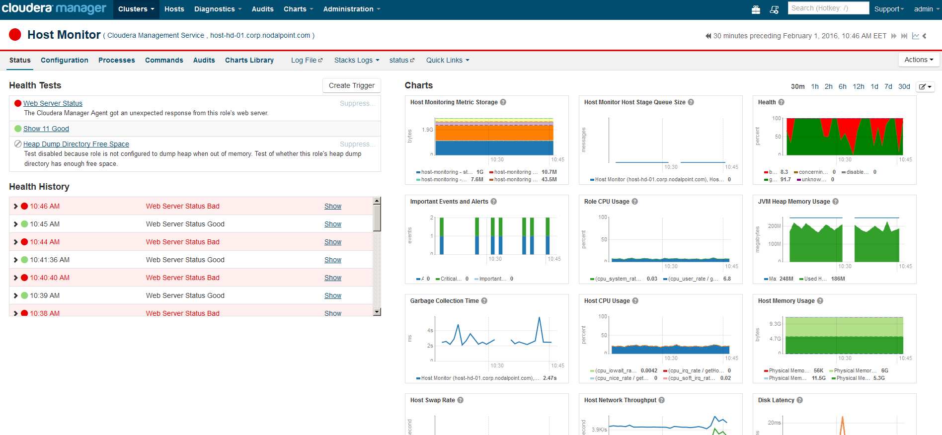

a) from the Host Monitor
[01/Feb/2016 10:44:34 +0000] 1237 Monitor-GenericMonitor throttling_logger ERROR    (8 skipped) Error fetching metrics at 'http://host-hd-01.corp.nodalpoint.com:8086/jmx'
Traceback (most recent call last):
  File "/usr/lib64/cmf/agent/src/cmf/monitor/generic/metric_collectors.py", line 165, in collect_and_parse
    simplejson.load(opened_url))
  File "/usr/lib64/cmf/agent/build/env/lib/python2.7/site-packages/simplejson-2.1.2-py2.7-linux-x86_64.egg/simplejson/__init__.py", line 324, in load
    return loads(fp.read(),
  File "/usr/lib64/python2.7/socket.py", line 351, in read
    data = self._sock.recv(rbufsize)
  File "/usr/lib64/python2.7/httplib.py", line 567, in read
    s = self.fp.read(amt)
  File "/usr/lib64/python2.7/socket.py", line 380, in read
    data = self._sock.recv(left)
error: [Errno 9] Bad file descriptor
with its corresponding screenshot

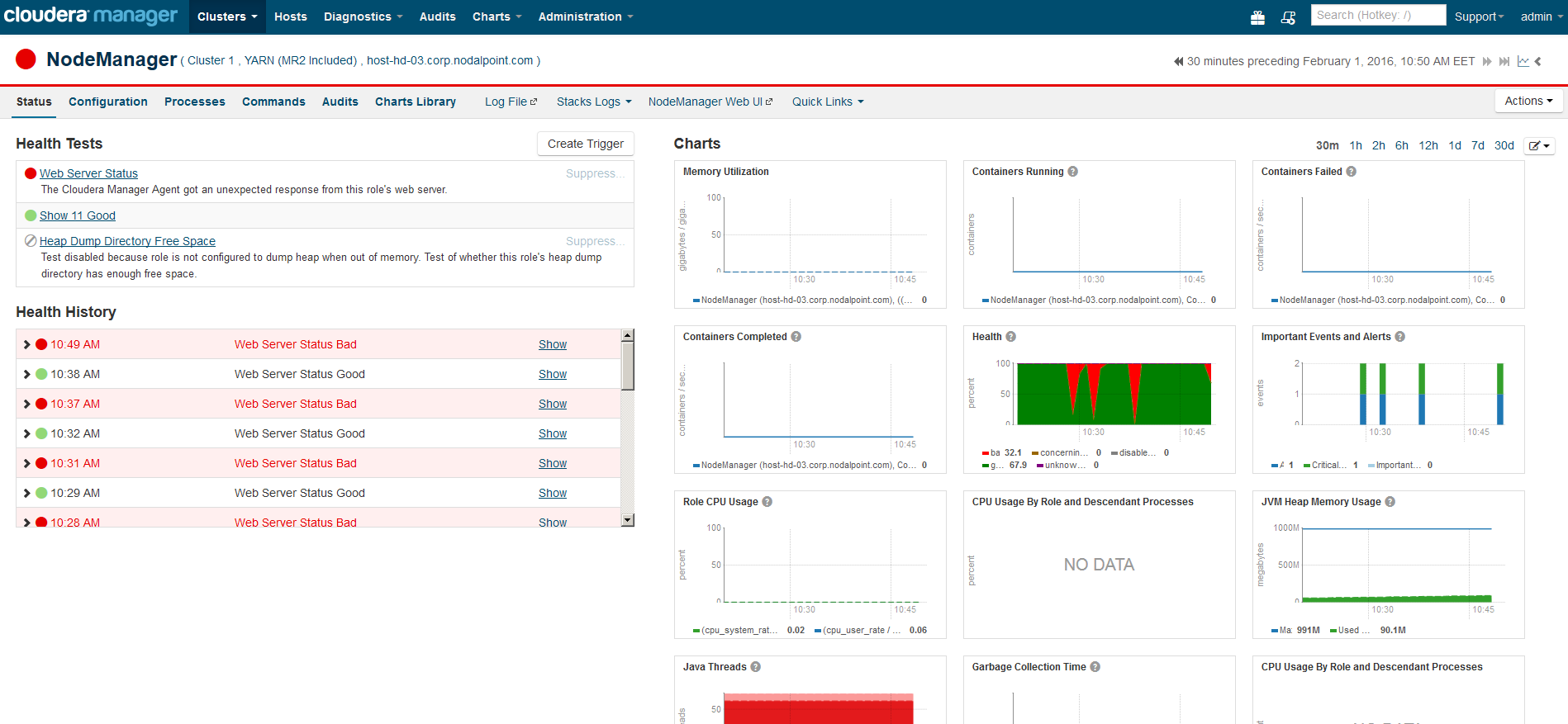

b) from a Yarn Node Manager
[01/Feb/2016 10:37:19 +0000] 1363 Monitor-GenericMonitor throttling_logger ERROR    (6 skipped) Error fetching metrics at 'http://host-hd-03.corp.nodalpoint.com:8042/jmx'

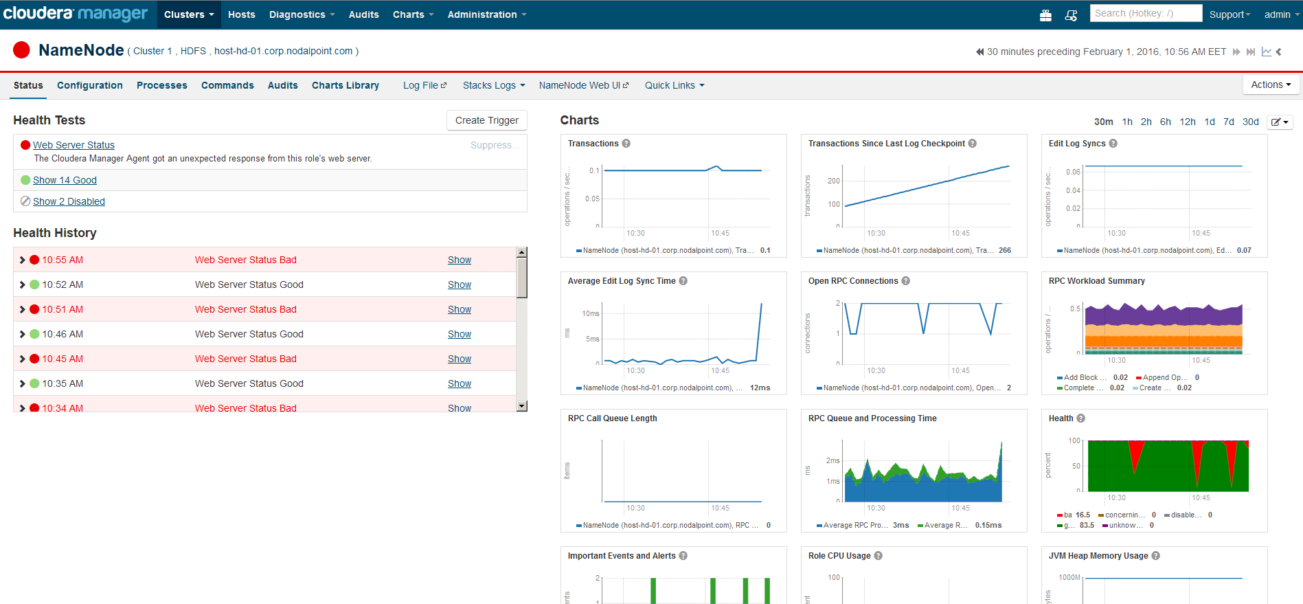

c) and from the Name Node
[01/Feb/2016 10:53:34 +0000] 1237 Monitor-GenericMonitor throttling_logger ERROR    (1 skipped) Error fetching metrics at 'http://host-hd-01.corp.nodalpoint.com:8087/jmx'
