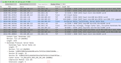

Access the https://192.168.1.81:8440/ca through a browser(192.168.1.81 is ambari server).I use wireshark to capture package,What information can we get from these outputs? ambari server supports TLSv1 protocol...
