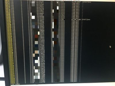

Version: CDH5.13.3, corresponding to hbase1.2.0
Nodes: Nine work nodes, three management nodes
Main role assignment: Nine regionserver, datanode, and solr server, three of which were lily hbase indexer
Background: Hbase for solr, solr stores the secondary index of hbase, and the index is automatically synchronized through lily hbase indexer
Question:
When creating the indexer number to 200+, we found a lot of TIME_WAIT port (almost 30000), in the regionserver log found this :"Retrying the connect to server: xx.xx.com/ipAddress:50020. Already tried 1 time (s); Retry the policy is RetryUpToMaximumCountWithFixedSleep (maxRetries = 10, sleepTime = 1000 MILLISECONDS)". when delete all the indexers , port back to normal, hbase back to normal Initial suspicion is that this version of hbase's multi-wal is in conflict with the replication functionality. Originally configured with 3 WAL, then we changed to single and re-created with 200+ indexers,although TIME_WAIT port down to about 10,000,but is still not solved,Can you give me some advice??
