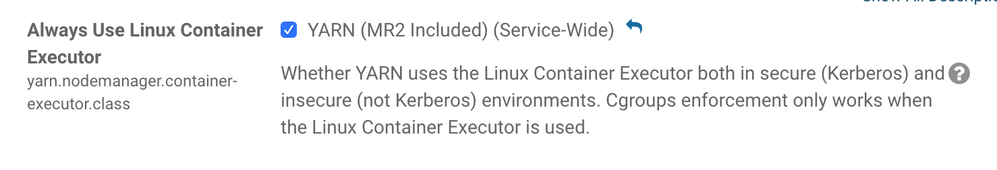

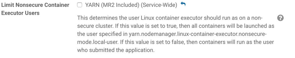

Are you sure you have "Always Use Linux Container Executor" checked and
"Limit Nonsecure Container Executor Users" unchecked, and no safety valves
overriding relevant properties? What CDH and CM version are you running?
Expert Contributor
Hi @Harsh J
Thanks for your response. Yes, these are the two configs you mentioned, and also I checked all the "safety valves" there is nothing related to any Linux or cgroups:
I have even remove the "nobody" user from allowed and left the "nonsecure-mode.lcaol-user" empty, but still says "nobody". If I revert all the changes, it says "yarn". So these configs impact something somewhere.

Expert Contributor
Hi @Harsh J
You mentioning the Safe Valve gave me an idea! I thought maybe the UI in CM is not setting one or both of those key/values. So I did this manually and it worked! Now every container asked by Spark Pipe() has the same owner as the Spark application itself (no more nobody or yarn! - there must be something with the UI that won't map one of those two configs back to yarn-site.xml):
