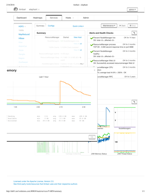

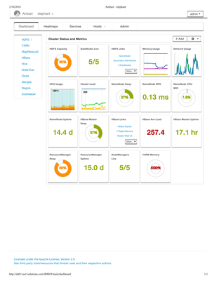

We have a cluster of 5 nodes currently running HDP2.0. Recently we observed that YARN is using 2000% of the memory.
Currently we allocated 2GB for yarn memory and the metrics showed 40GB was used for our current job. All nodes are still "alive". Will that be a problem? Should we increase the allocated memory for yarn cluster?

@Jade Liu
You should look into the option to upgrade your system.
HDP and Ambari needs to be upgraded.
You can increase yarn memory. Restart yarn to see if alert goes away
