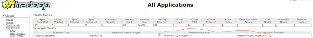

@saranvisa unfortunately we are not using cloudera manager .....we are using apache hadoop 2.7.3 and yarn that comes along with it .......also i made sure yarn-site.xml is updated on all nodes and have same values ...
this is what yarn reflecting
this is what configured in yarn-site.xml which is configured for 22GB and 7 cores but it's jus using 16GB and 6 cores not sure why

Champion
@srirocky
The image that you have pasted is not visible (under "this is what yarn reflecting")
