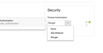

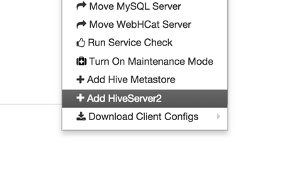

@Raja Sekhar Chintalapati See this http://docs.hortonworks.com/HDPDocuments/Ambari-2.2.0.0/bk_Ambari_Users_Guide/content/_adding_a_hive...
and once you enable Range plugin then it will be enabled globally for hive.

You can see the above screen shots.
