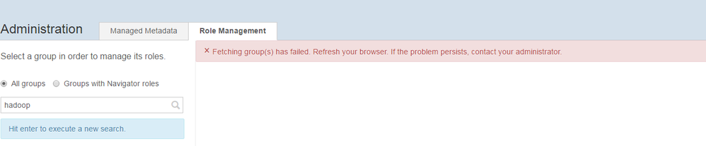

I integrate the AD with navigator using http://www.cloudera.com/documentation/enterprise/5-6-x/topics/cn_sg_external_auth.html And now i am able to login the navigator from AD user.
My problem is that the user which have administrator writes are not able to search allgroups inside role management tab. On seraching any group it give error:
Fetching group(s) has failed. Refresh your browser. If the problem persists, contact your administrator.
Can anyone help me for solving the issue.
thanks in advance

Hi Prakul,
I guess you need to add UserSearchBase and GroupSearchBase.
I think this also needs to be added to official documentation.
thanks ngurjar for quick help. I also found a good document for integrating AD with navigator the URL of doc is http://blog.samoylenko.me/2015/02/01/configuring-cloudera-navigator-external-authentication/
After following this doc i am able to run navigator properly
