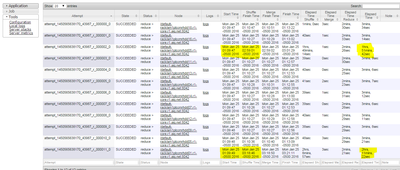

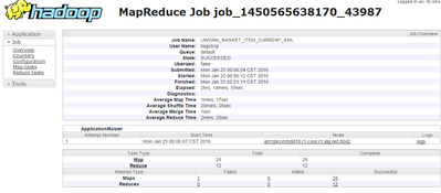

@Artem Ervits : I guess i have provided incomplete information , my apologizes. . This is a hive job which selects data from few tables unions them and then insert overwrites into one other table ( i donot have info for the amount of data the original tables, probably they were dropped ). The job actually spuns 28 mappers 12 reducers , out of this 10 reducers have completed the job under 3 mins expect for 2 which took approximately 2 hours .
This job is a cron and it has been running for quite few days , no config changes were done from infrastructure end .
One other odd thing about this is that some days it spun reducers and other days it doesn't . ( does this depend on the amount of data that is being parsed ?
The initial post yarn logs shows @ what point it took long and where it took long time
  • 2016-01-2500:10:27,135 INFO [fetcher#22] org.apache.hadoop.mapreduce.task.reduce.ShuffleSchedulerImpl: XXXXXXXXXXXXXXXXXXXXXXXXXX:XXXX freed by fetcher#22 in 5ms
  • 2016-01-2502:18:46,599 INFO [fetcher#12] org.apache.hadoop.mapreduce.task.reduce.InMemoryMapOutput: Read 296787239 bytes from map-output for attempt_1450565638170_43987_m_000010_0

Also both of these log entries are shuffle related for the most part, its the Reduces fetching the Map outputs from nodes in the cluster. Which leads me to question things like network transfer rates the NICs had when this occurred, as its only 2 nodes that demonstrate the slow shuffle times. I am not sure if you have metrics available tho or not.
