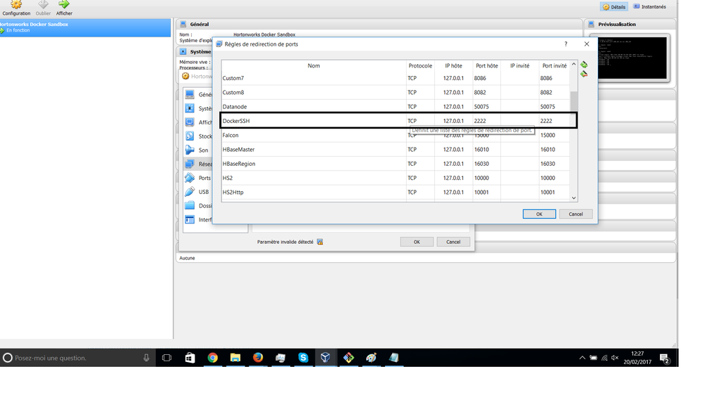

This did not work before , displaying "connection refused". I have just tried now and still facing the same display.
You can see the port configuration on the docker machine on the joined pictures

\Your screen shot suggests that you are trying to do [ssh root@127.0.0.1 -p 2222] from inside your sandbox which is not right : Following is the output that i got from your attached screenshot "2222conectionrefused.png
" You are already inside the sandbox in that screenshot as following:
You should do ssh from your local machine (laptop) to the sandbox VM
Master Mentor
@Oriane
Looks like all those command not found errors are occurring because you are doing SSH using an incorrect port. 2122. You should be using the following:
Can you try this.
