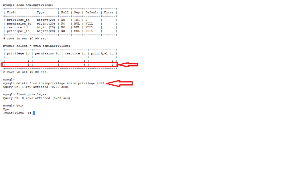

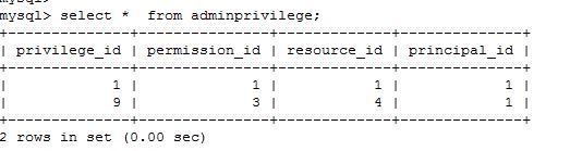

The problem of Manage Ambari option resolved this is what I did !
Logged on the Ambari node where the MySQL database is running. Switch to the Ambari database and deleted the entry in adminprivlege with privilege id 9 I just guessed that id 1 was created first for the ambari Admin which was a correct assumption
# ambari-server stop
# ambari-server start
But prior to deleting the above entry I run these 2 API's
Delete a user using REST API
curl -iv -u admin:admin -H "X-Requested-By: ambari"-X DELETE http://ambari-server:8080/api/v1/users/{user}
Delete a group using REST API :
curl -iv -u admin:admin -H "X-Requested-By: ambari"-X DELETE http://ambari-server:8080/api/v1/groups/{group}
Hope that helps someone

This issue occurs when ambari ADMIN user is given operator privilege or is added to some group that is given operator privilege. I logged into the ambari database, deleted the entry that got created related to this new user from ADMINPRIVILEGE table/ restarted ambari-server and now i can see the manage ambari link when logged in as admin.

I hit the same problem a I have 2 entries in the MySQL DB for the adminprivileges ? I guess the id.1 is for the admin but I don't want to take a guess so could you tel me what exatctly you deleted?
New Member
@Geoffrey Shelton Okot
yes that's correct, id.1 is for admin , i deleted the other entries.
