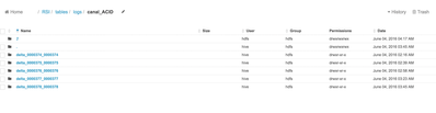

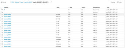

I have lunched 5 batches, one per month and in hive directories i can see that why??? inside de delta there are all the bucket, is corret???
1 ACCEPTED SOLUTION
Super Collaborator
both compactions are important. The should run minor compactions more frequently to combine delta files into fewer deltas. From the listing above major compaction ran and produced the base file. All the delta files in the listing should be garbage collected by the system. Could you provide output of "show locks" and "show transactions"? The only thing that should prevent deletion of these delta files is a query that is still running which the "show" commands should indicate.

Yes, if you are using ACID operation then these delta file should create for each partition and inside it you will see the no. of buckets which got some change during ACID operation. These delta files should be merge with base records as per the compaction policies.
