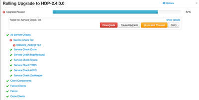

I am upgrading one of our cluster from HDP 2.2 to HDP 2.4.0. version.
80% of upgrade is completed and all the core, slave,hive, spark are upgraded to latest version of HDP 2.4 . During the service check phase, Tez component is failed.
The status I see in the Application monitoring URL is
YARN Applicaiton Status: ACCEPTED: waiting for AM container to be allocated, launched and register with RM.
It waits in that state for sometime(300 seconds) and dies and the service checke is failed.
Verified that enough memory is available in the worker node

1 ACCEPTED SOLUTION
Master Guru
Since service checks of all major services were successful, you can just select "Ignore and Proceed" and handle the Tez issue once the update is over.

Master Guru
Expert Contributor
Thanks . That resolved the problem. I just continued with "Ignore and Proceed". Before finalize I ran the Tez job manually and it ran without any error. Do you know what was causing the the Tez job to be in ACCEPTED state and timed out after 300 seconds.
