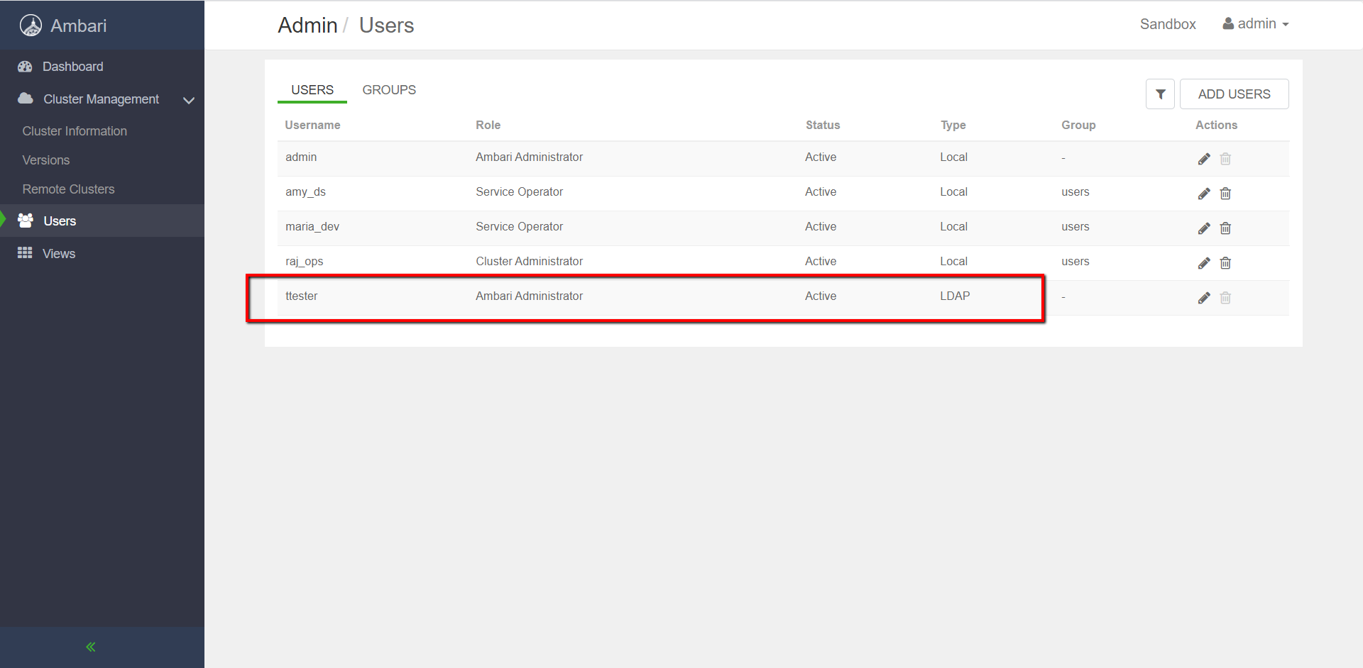

Just had a hunch and restarted ambari-server using
ambari-server restart
This is not directed in the documentation! https://docs.cloudera.com/HDPDocuments/HDP3/HDP-3.1.4/ambari-authentication-ldap-ad/content/amb_ldap...
This makes the LDAP login work succesfully!

@stevenmatison well I've setup Ambari/LDAP integration. The LDAP users show up in the Ambari user admin, and I've assigned one of them as Ambari administrator. However it is not possible to login with this user due to invalid credentials.
INFO [ambari-client-thread-111] AmbariAuthenticationEventHandlerImpl:136 - Failed to authenticate custom.user (attempt #1): Unable to sign in. Invalid username/password combination.
I can login with the user in the LDAP admin interface, just logging into Ambari doesn't work. The username must be correct, because otherwise the error message states:
INFO [ambari-client-thread-303] AmbariAuthenticationEventHandlerImpl:136 - Failed to authenticate cn=custom.user,dc=customdomain,dc=com: The user does not exist in the Ambari database

Created ‎01-06-2020 03:59 AM
- Mark as New
- Bookmark
- Subscribe
- Mute
- Subscribe to RSS Feed
- Permalink
@stevenmatison thanks for your continuing reply.
I really can't make sense of it. I respect that this is probably not related to Ambari/HDP anymore but the issue is that actually I am at the point of: "here are all the settings". I keep redeploying both the LDAP server and the Sandbox from a fresh install... 🙂

I make the user admin in Ambari
But whatever value i use for login it just won't work 😞
- ttester (uid)
INFO [ambari-client-thread-244] AmbariAuthenticationEventHandlerImpl:136 - Failed to authenticate ttester (attempt #1): Unable to sign in. Invalid username/password combination.
- tester.tester (cn)
INFO [ambari-client-thread-33] AmbariLocalAuthenticationProvider:71 - User not found: tester.tester
INFO [ambari-client-thread-33] AmbariAuthenticationEventHandlerImpl:136 - Failed to authenticate tester.tester: The user does not exist in the Ambari database
- cn=tester.tester,dc=example,dc=com (cn)
INFO [ambari-client-thread-240] AmbariLocalAuthenticationProvider:71 - User not found: cn=admin,dc=example,dc=com
INFO [ambari-client-thread-240] AmbariAuthenticationEventHandlerImpl:136 - Failed to authenticate cn=admin,dc=example,dc=com: The user does not exist in the Ambari database
