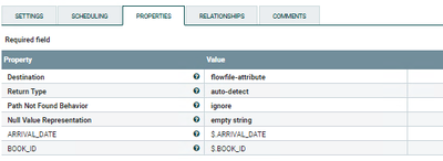

Hello, I have a json flow file as follows:
I used: EvaluateJsonPath:
But the result is: < Empty string set>
Thanks for your help and guide.
Visitor
You are using an array, this is why you got null values. You have 2 options:
  1. Change the expressions to $[0].ARRIVAL_DATE and $[0].BOOK_ID, and it will work
  2. Read the file and split the array using the SplitJson processor - set JsonPath expression to: $, and connect the SplitJson processor to your EvaluateJsonPath processor and it should work.
