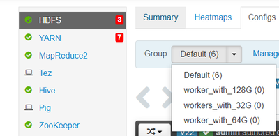

in Ambari HDFS Configs , we configured 3 config group because the following:
1) 212 data nodes machine are with 32G
2) 119 data nodes machines are with 64G
3) 197 data nodes machines are with 128G
so in Ambari we have following config group settings

when we run above cli , the parameter -  dtnode_heapsize was update but not on the groups !
what was update is the parameter in the default group - "Default"
so how to set the parameter - dtnode_heapsize , according to the relevant config group?
