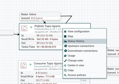

You can still see the stats from the processor by hovering the cursor over the processor and right=click, then a menu pops up and you can see the Status History of the processor:
A new window opens with a choice of stats to view

@Mitthu Wagh the 5-minute window is not currently configurable. However, NiFi does take a snapshot of these values (and several others) every 1 minute (by default) and when you right-click on a Processor, you can go to Status History. This will graph that value over time. By default it will grab those 5-minute statistics every minute for 24 hours. This can be changed by updating the "nifi.components.status.repository.buffer.size" and "nifi.components.status.snapshot.frequency" properties in nifi.properties. You could also get these values via a Reporting Task if you wanted to push them somewhere else such as Grafana for longer-term storage.
